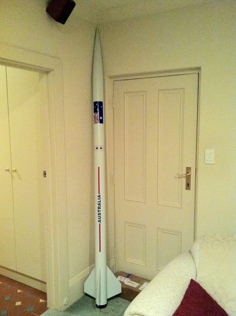

Nervous rocket shivering with fear in the corner...waiting for the big day...

Looking good Goffa  icon_thumright Gees would not want anyone to open that door up though!  blundecided
« Reply #102 on: April 14, 2011, 10:46:03 PM »
They are a nice looking rocket, Love you choice in decals!!
what motor you got planned for it?
Hehe, with the amount of epoxy on that thing, you're more likely to damage the door I reckon! Tongue

« Reply #105 on: April 15, 2011, 06:20:37 PM »
love the aussie art work Goffa  icon_thumright

« Reply #107 on: April 15, 2011, 08:37:10 PM »
dunno...let me go and have a look in the ammo box....
I'm back..found an old motor in the bottom of the box...seems to fit ok
let me wipe off the dust and see what it says...m1297w
might give that a go...
