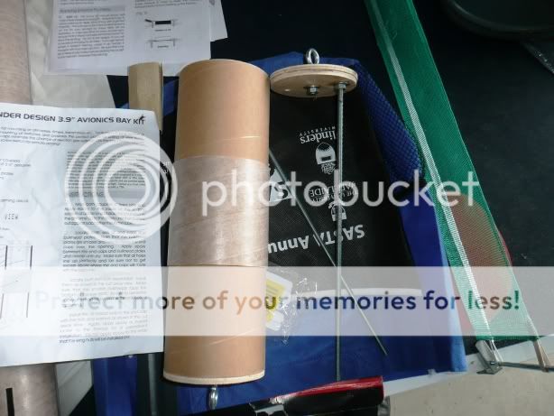

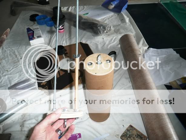

The following morning I continued on the avbay (after another fin-fillet). I epoxied eye-bolts and then attached the threaded rods to one of the plates. These rods keep the avbay as a single unit and also serve as a mount for any electronics you may (or may not) possess.
In my case, I've got a cruddy little USB-altimeter to attach, so instead of making a "slide" out of G10 or balsa sheet as mentioned, I'll probably just hot-glue gun my alt to a carboard tube used to hold a HPR igniter. These tubes also make great launch lugs for MPR rockets:

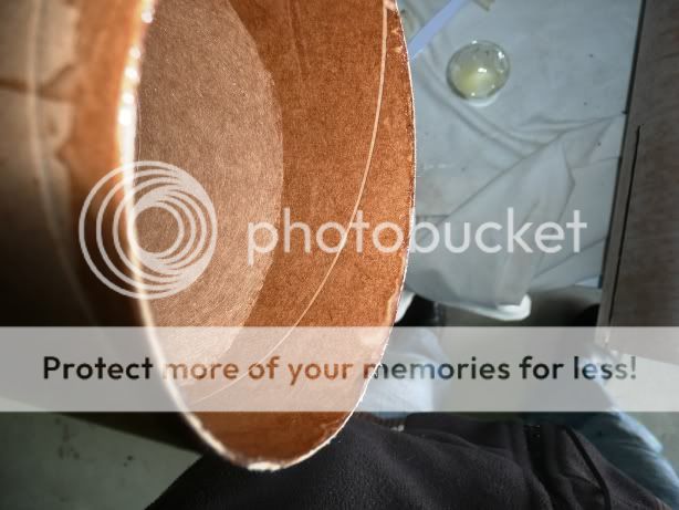

Finishing off the avbay... I smeared a super-thin layer of epoxy around the end of each coupling tube to reduce wear & tear... After a sand this thing should be a bit more plastic and durable, I hope. I used a cheap, crappy plastic knife as a spatula to get a really thin smear. It worked quite well.

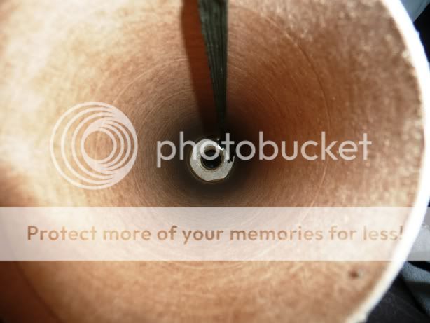

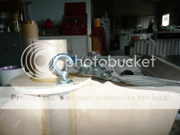

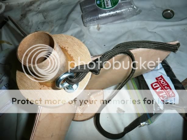

Well, after many hours of curing time, the fin can is just about ready! I had considered organising some kind of heat-lamp to speed up the cure but it wasn't necessary really. Rocketry is about patience, sometimes, eh? Last thing to do is attach the recovery harness before reinserting the fin-can.
Knots... knots!!?!?!? This is rocket club, not the scouts! I just learnt a new knot. It actually seems pretty good.
As per destructions... I lathered it in epoxy, presumably to avoid someone suing Binder because their knot turned out shitty. I actually think mine was ok. Anyway, it's going nowhere now!

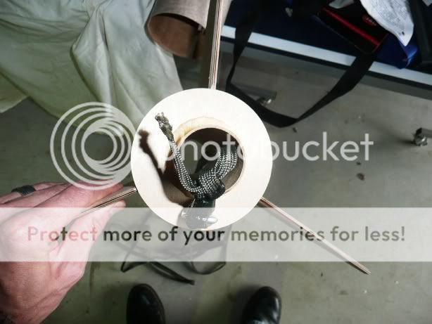

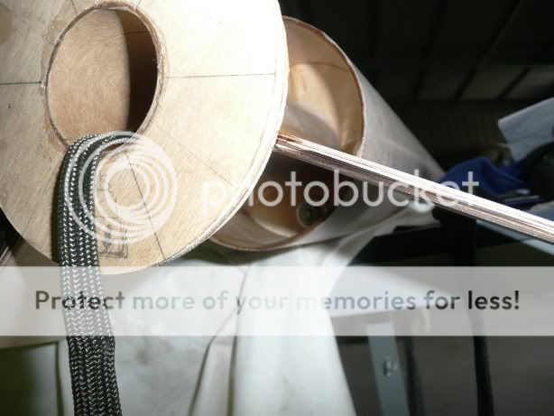

The fin can is ready to be glued into the airframe, BUT... how do I stop the harness getting smeared in epoxy meant for the front centering ring? In the end, I decided to poke all the "rope" through the motor mount. That way, I can add epoxy and insert the fin-can without the harness being in the way at all:
Harness through the tube.
Checking the distribution of epoxy. I added a bit more after looking at this.
