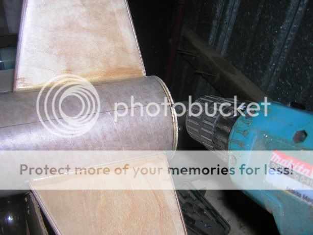

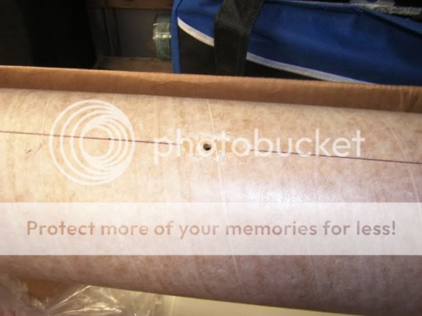

back on the rock... it was time to work on the rail buttons. First I needed to rule a line to make sure the buttons were lined up.
The destructions called for the aft rail button to be drilled 1/2" from the back. If I'd done that it wouldn't have been drilled into a centering ring, which I would prefer to do. I think that the 1/2" measurement might've been for older versions of the excel, though, because the new excels have the thrust plate and aft centering ring right at the back. Anyway, I decided to drill the aft rail button into the aft centering ring instead of at 1/2"
I also used rocksim to figure out the CG of the Excel Plus, which was where I drilled the forward rail button. It was about 4" forwards of where the destructions called for it to be located. I hope I've figured them right!
After drilling I gave the holes a sand to remove the glassine, and roughed up the buttons too, to make a stronger bond. Last thing was to wick a bit of glue into the holes to toughen them up. Once that's dry I'll be screwing in these rail buttons, and ready to paint!

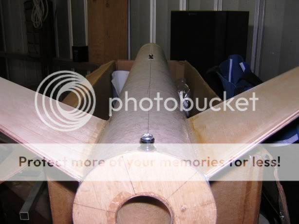

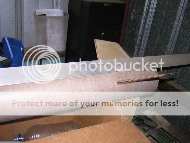

This was my first time using rail buttons... following the steps supplied by binder, i wicked some epoxy (oops, was meant to use CA oh well) into the holes and waited for it to dry to toughen the holes up. Then I roughed up the underside of the buttons, smeared epoxy on the screw and underside of the buttons, and screwed them into the body tube. They look lined up ok, will find out when I try to slide it on the rail i guess!
i still can't believe the set up of these buttons... do they really stand up under the force of a J motor?!?! There's really not that much area gripping the tube, compared to a launch lug anyway. I know which one would be harder to rip off (well, I think I know, anyway)

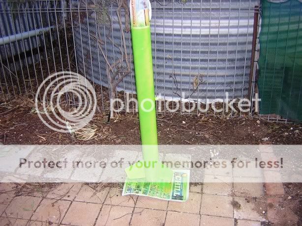

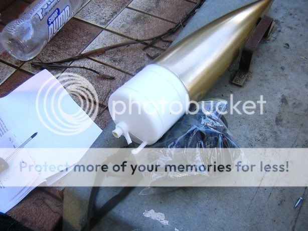

in the meantime, i started spraying the upper section
and once the buttons glue had cured I started spraying the lower section

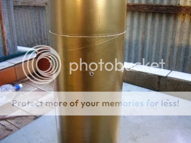

one of the last things I need to do is screw the nose cone to the body tube... the instructions don't mention how many or what size... any advice people?

I generally screw the top BT to the AV bay and have the ejection charge push the nose cone off and main chute out.
but to screw the nose cone on just go 3-4 little wood screws. maybe something like 6mm x 10mm long (short 1/4" coarse thread screws) dome head.

Nah not in this case, Loki. This is a binder kit but the screws were not included. Not complaining, though, as this kit came with a retention system for free Smiley
I've got some small screws that will do the job...

« Reply #65 on: June 05, 2011, 09:38:11 PM »
drilled the holes...
started gluing & screwing (similar to doing a rail-button, really)
haha, idjit... forgot to tie the shock cord to the nose-cone  fanembarrassed that could've been a tricky fix once the glues & screws were set. I'm putting it down to being over-excited. I didn't glue the shock-cord this time, just tied a few extra knots, with the idea that I may change the config of the front end sometime in the future.

« Reply #66 on: June 05, 2011, 09:54:54 PM »
u didnt need to glue those screws in cause if u do dual deploy later you want the nose cone to come off.
but nice looking rocket well done.
but u have committed a sin  evil3 you painted on top of your bbq man i cant belive you defaced the bbq going to have to report this to the RSPC BBQ........lol
 dizlaugh cheers man, but nah - it's the old bbq. I think it's just a playground for spiders now. I've got one a them fancy bbq's on wheels  icon_geek
not sure about the screws... i think they'll come out again with some encouragement. I added a bit of glue to make sure they didn't unscrew themselves. Worst comes to worst I'll just drill 'em out if I want to make serious mods.
As for dual-deploy... this kit is still good to go on that front. The av-bay ejects backwards instead of the nose cone, forwards. Does that make sense? I'm just doin' what i'm told  icon_salut
