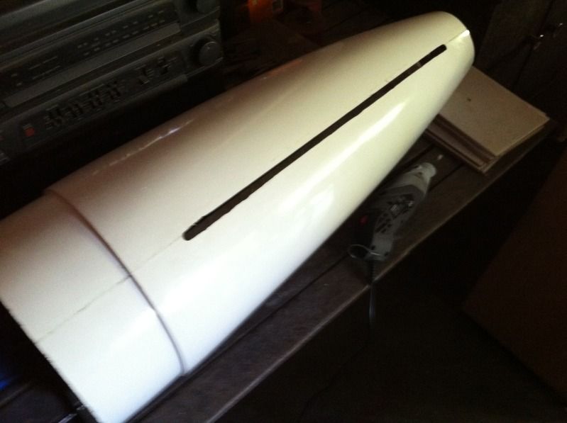

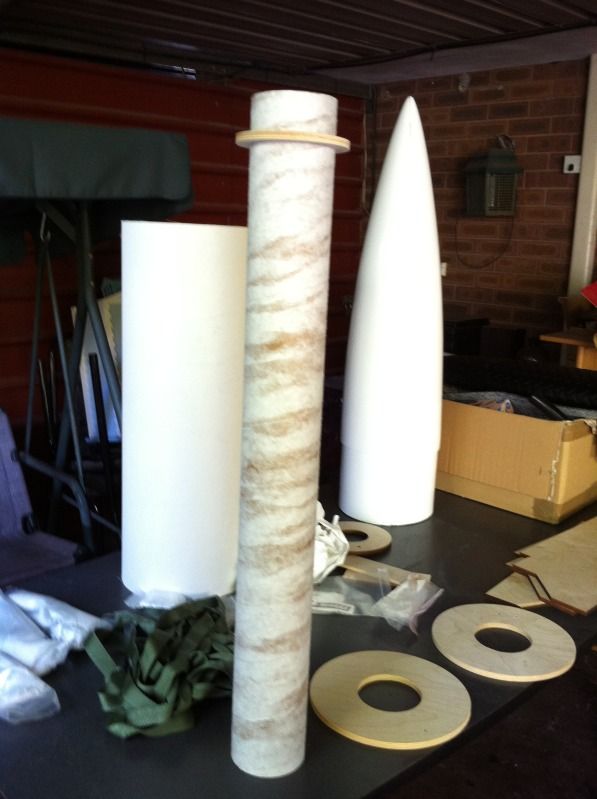

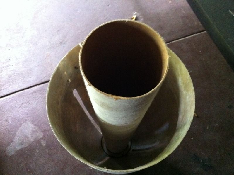

below is the motor mount tube i have peeled the tube

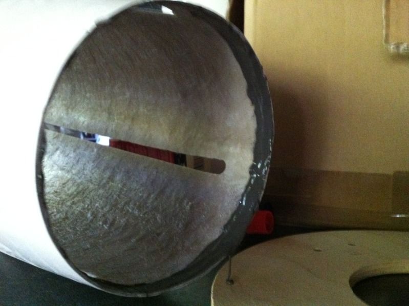

tailcone fin slots needed some more trimming so out came the dremmel

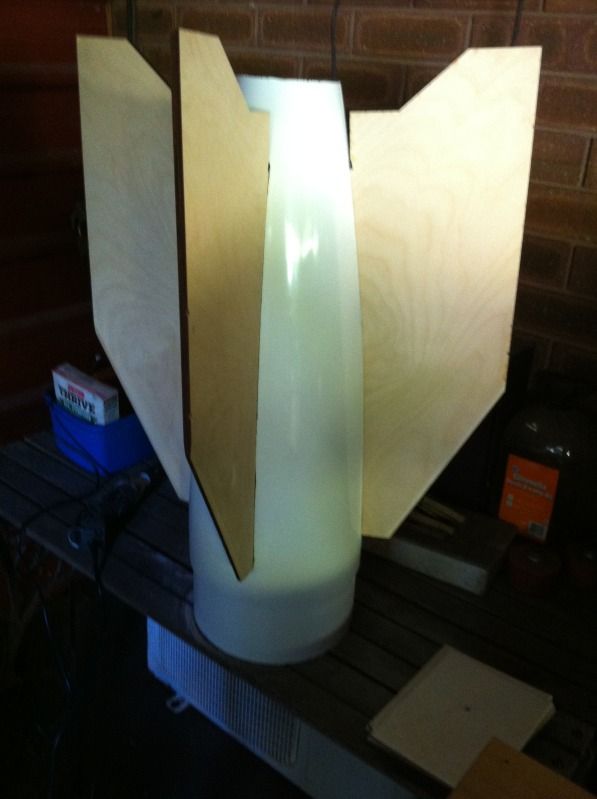

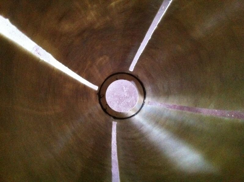

« Reply #22 on: July 24, 2012, 11:09:47 PM »
test fit of the fins into the tailcone
rear centering ring test fit

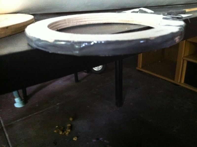

« Reply #23 on: July 24, 2012, 11:16:01 PM »
glueing the rear centering ring in on the trimmed tailcone
JB weld smeared over the face of rear centering ring to help protect it from exaust flames which are a common problem on the V2s over time

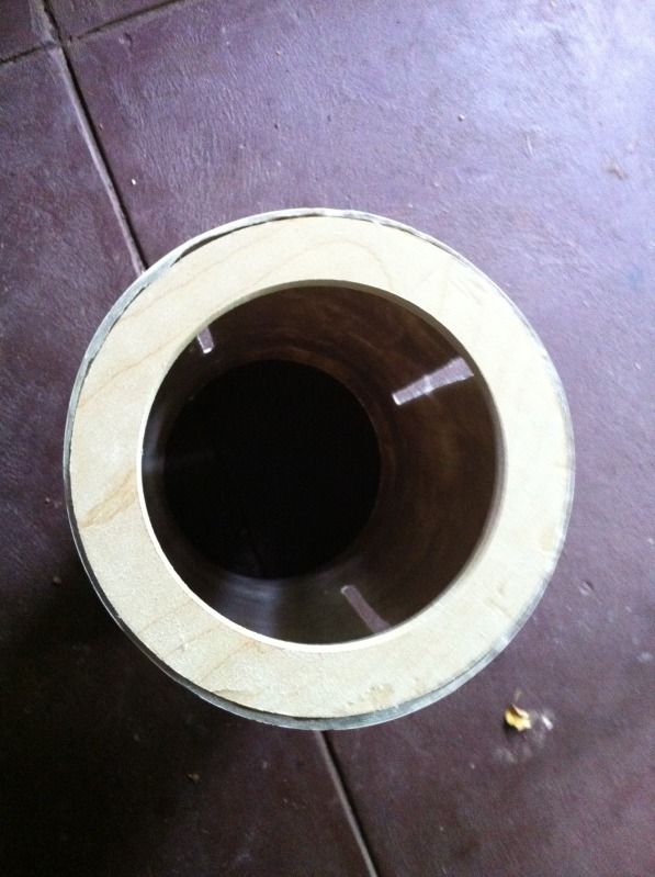

« Reply #24 on: July 24, 2012, 11:18:41 PM »
nice and dry all gaps filled with epoxy
now the motortube needs to be glued in
