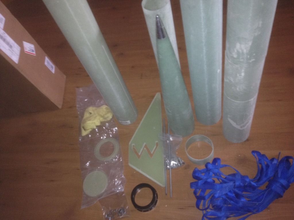

well most of you know what i am building so i might as well start a thread.
i brought a Wild Thang for my L 3 attempt and it is also my first glass kit so lets see if i can stuff it up.
well here it is.
parts list
1 nose cone
1payload section
1 av bay
1 booster section
1 75mm motor mount
3 center rings
3 cool fins with a big W cut in them
1 retainer
shock cord
and eye bolts.
no parachutes i will let this one just fall back to earth.. no i have chutes already. diztongue
