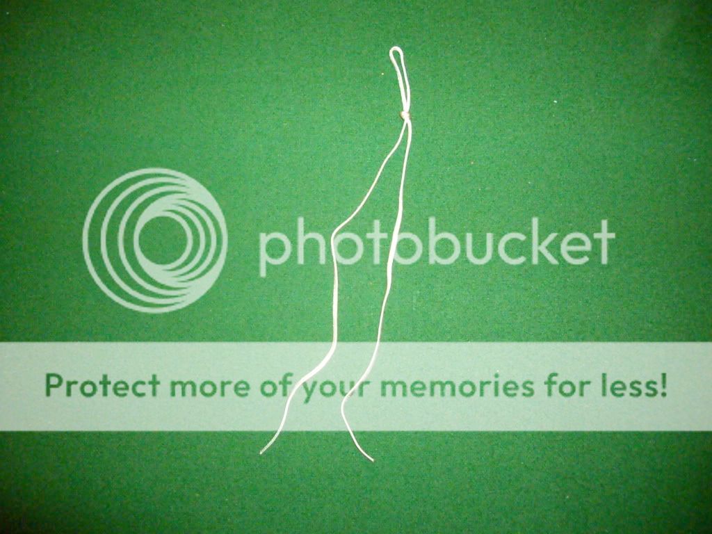

Next item is the shock cord mount. The instructions recommend "FOLLOW INSTRUCTIONS CAREFULLY"

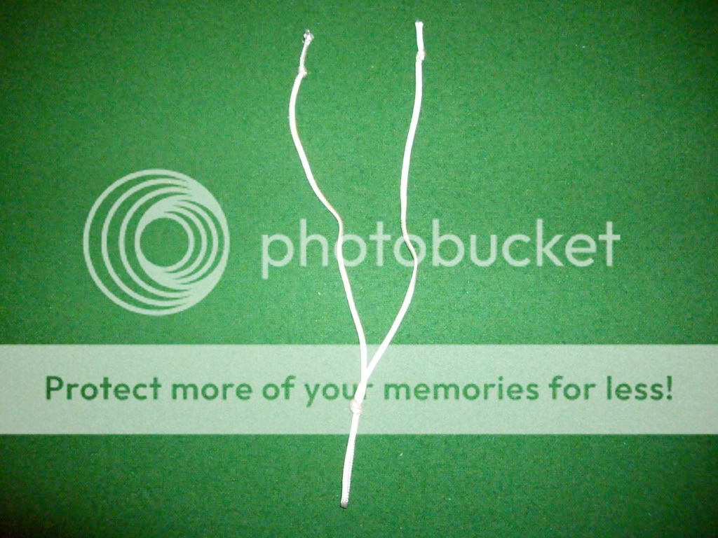

As per instructions had made an approx 1 inch loop at centre
Instructions also stated to make a knot approx 1/4 inch away from end which was done

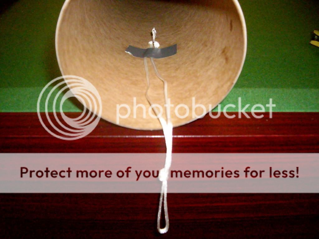

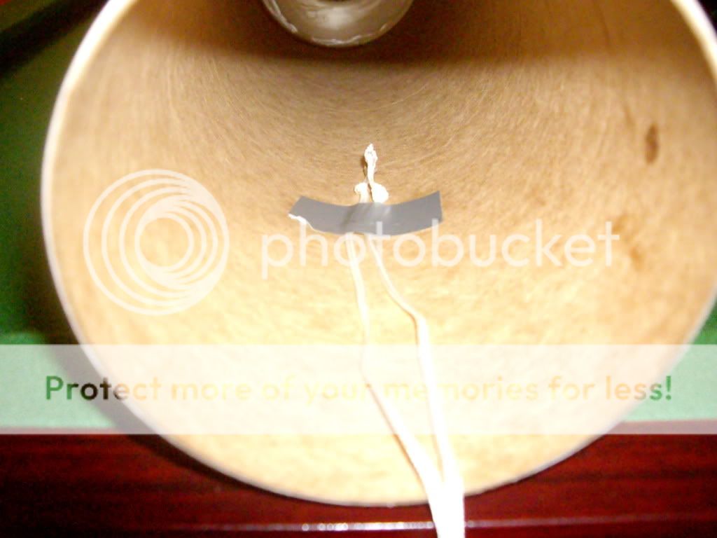

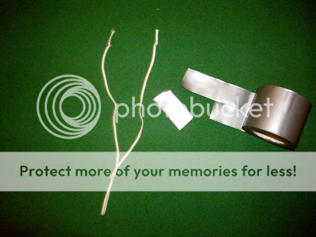

Recommendations next were to use a piece of masking tape at a certain lenth and thickness. Knowing full well if this procedure was not done correct the fantom could come down in two pieces. Was not satisfied in using plain masking tape so used somethink stronger as shown in photo
As per instructions this was taped inside the tube with recommended distances

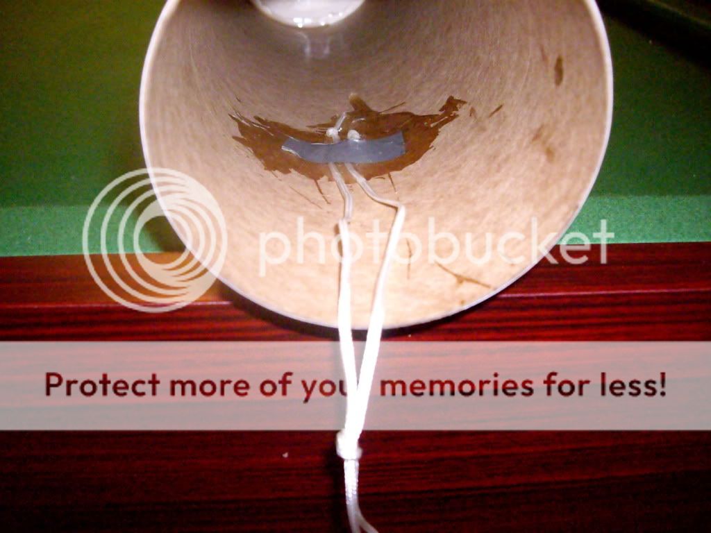

Last procedure was to place lots of epoxy over this tape to ensure it wont give way! Instructions recommended to be gernerous which was.
That concludes the shock cord mount. Next process will need sanding sealer. Crap I dont have any of that so will need to get some!  Sad
